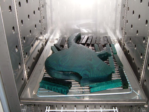

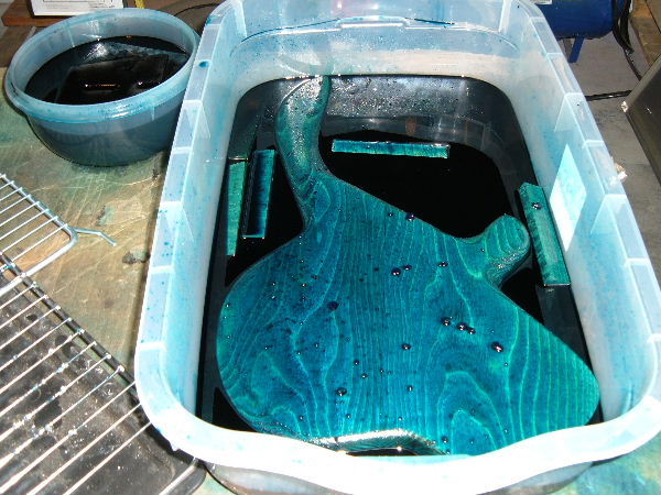

How about a whole bass body? We did this for Bee Bass along with a curly grey ash top and curly grey ash fingerboard. This body (and other woods with it) is more than dyed as I put the dye in my acrylic resin mix, impregnated the wood thru and thru (vacuum/pressure), then polymerized it. No finish required, just sand and buff. This bass was for winter NAMM, but Fred didn't get it done in time.
